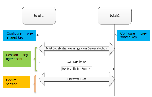

The following figure illustrates the deployment of MACsec using MKA protocol.
Switch to switch MACsec deployment scenario
